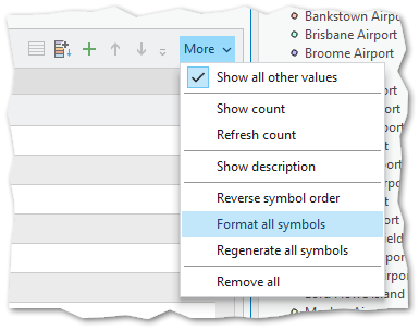

MicZatorsky_AEC
To update the size of many symbols from the Symbology pane select More > Format All Symbols
