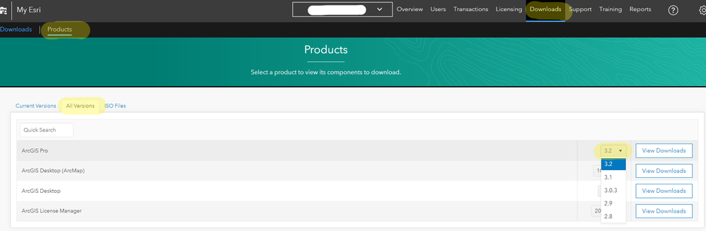

Hi there,
You should be able to download earlier versions of ArcGIS Pro from the 'Downloads' section of MyEsri.
Just make sure you download the appropriate version for your version of ArcGIS Enterprise.
