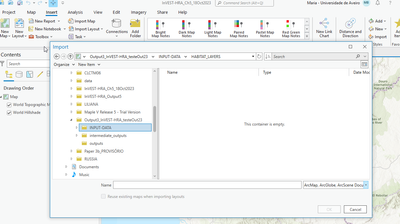

I´m trying to import into a file geodatabase, shapefiles I have built in ArcMap.

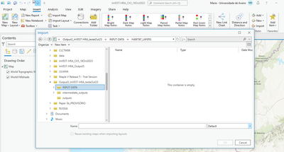

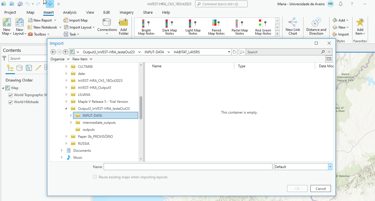

For this, I am following the steps I’ve learned in introductory ESRI videos on the issue. Here are the steps I am following: go to the “Insert” tab à the “import map” button à I navigate to the location in my PC where I have the ArcMap files stored.

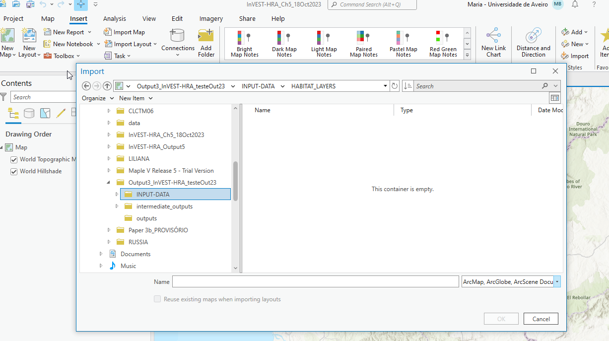

When I reach this stage, a message appears saying that the folder is empty, and no file appears in there.
I have tried to change the file extensions into ArcMap, ArcGlobe, … but the but the discouraging scenario remains…
 I have tried all the files extensions and the folder keeps being shown as empty!
I have looked for more webinars and teaching videos on how to do this and they all refer the same processus I have followed (which does not work with me…).
Can someone help me solving this problem? How can I get access to information I have built before, using ArcMap?

Are the .mxd files in that folder?
That is what the import map tool is looking for. Not a file geodatabase or shapefiles.

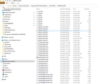

I've just checked and, in fact, there are NOT .mxd files in my folders...
However, the files I have there were built with ArcMap. Wouldn't it be supposed to be automatically suitable to be compatible with ArcGIS Pro? ... (as I told I am not very agile using ArcGIS 😞

Shapefiles and geodatabases built using ArcMap can just be visible in the Catalog pane.
You're trying to import an ArcMap .mxd document.
