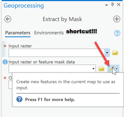

Extract by Mask (Spatial Analyst)—ArcGIS Pro | Documentation
but first you need to create a new featureclass to hold your polygon...  however, there is a shortcut!!!
which you can document in your report for Tuesday

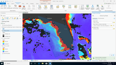

Ok so basically I have 2 rasters of the whole US of chlorophyll data. I only want to focus on the east coast of FL. One raster is from 2004 during a red tide bloom and the other is from 2010 where is was normal. All I want to do is create two rasters of just that coastal spot and compare the difference in chlorophyll amount. When I used extract by mask just now I may have put the whole rasters in the wrong spot but it created a layer that's greyscale and doesn't show up as anything when I turn all other layers off. I wish people could live chat on here lol.  Screen shot seen below

you have to move stuff up and down in the table of contents to see stuff and do some toggle on/off.  Also remove any stuff that you don't need when you are done with it.
Hopefully everything is the same coordinate system or the layer of complexity just notched up..
As for the grey scale, rightclick on the layer and change the symbology, it is probably greyscale and stretch... change it if you want colors, or use "apply symbology from layer"
