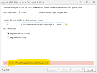

How to import the Replica XML with "Register existing data"?
With Import XML schema I get a "Invalid data" error.
The two databases are set up identically and sync without Register existing data works.

Great question - here's what I've been able to find out why the wizard fails for an XML file with "register data only" set for it.  The Wizard is validating that the input is a Geodatabase XML workspace document (the XML format produced by Export XML Workspace Document). A replication XML created for geodatabase replication—especially when “register data only” is used—is not a workspace document (it’s a replication message/package), so the Wizard rejects it and surfaces the generic message “Invalid XML Workspace Document file provided.”

Thank you. Yes, that were the steps I did take. However my workflow was just starting all tools from the context menu instead directly from the toolbox search, that was my mistake.
For some reason there is a difference between using the "Import XML Workspace Document" toolbox (it works fine) and starting the process by right clicking on the "sde -> import -> XML Workspace Document" which starts the "Import XML Workspace Document Wizard" instead of the "Import XML Workspace Document" toolbox.
The Wizard fails to import XML files that have the option "register data only" selected, but passes with xml replica files where this option is not used.
This is confusing as selecting any other tool via "sde -> export/import" does start a toolbox and not a wizard.
What is the idea behind having "Import XML Workspace Document Wizard" and not just starting up the "Import XML Workspace Document" toolbox? I see that there is some field matching preview, but this can also be implemented in a toolbox.
