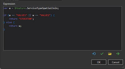

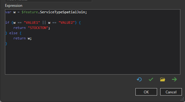

Hello, I am creating a report in ArcGIS Pro and using an Arcade expression to group two field values into a single label. The field I am referencing comes from a spatial join.

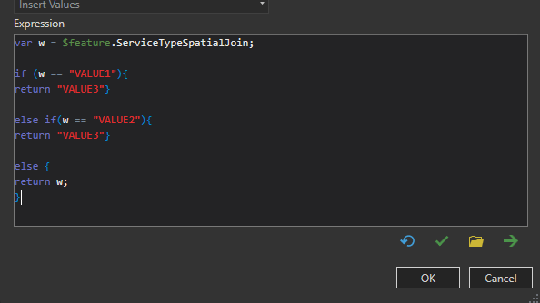

I have also tried other alternatives such as using what if statements.
The expression returns nothing. So how should joined fields be referenced inside report expressions? Do joined fields need a specific syntax in Arcade when used in a report?
