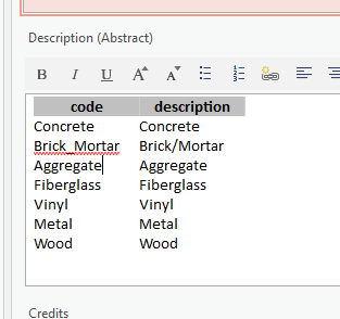

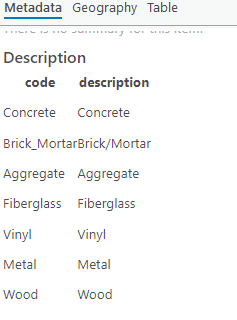

Not a direct method. However, you can do it by using the Domain to Table function and exporting the domain to a table.  Then open that table and copy the Domain values and pasting them into the Metadata

If you select all values from the domain to table table it should literally be one copy, one paste
COPY
PASTE
Though it may work easier to create your metadata description in Word and then paste it all at once.

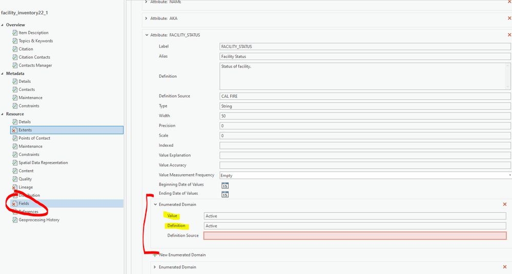

@RobertBorchert I see what you're saying but you're updating the domain in the item description, which is an open text field. That's not really what that's for. It's a wide dataset with a whole host of fields, several of which have long domains. To put all of those in open text is impractical.
Our org uses FGDC format. Each code/description combination for each item it domain has its own text box, making copy/paste all at once impossible. Each 'enumerated domain' is a single code/value description that needs to be added individually if they don't carry over automatically (which is in itself perplexing, since it's not consistent. See below.
