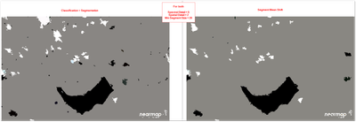

Would the Image Classification Tool  Segmentation be expected to return a different result to the Spatial Analyst tool Segment Mean Shift given the same image input and parameters?

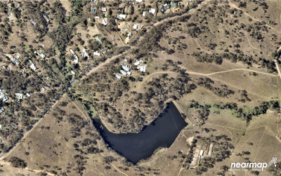

Given input image for both:

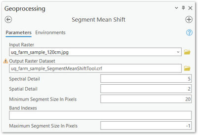

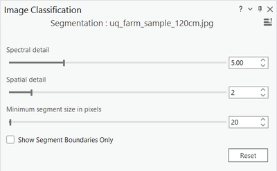

With the same parameters for Spatial detail, Spectral Detail and Minimum segment size in pixels:
The process:

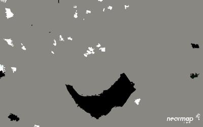

Classification > Segmentation
Results in:

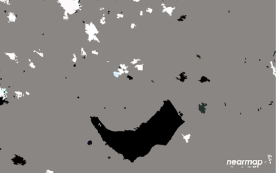

Segment Mean Shift, with the same parameters:
Results in:

Both tools have the same layer as input - i.e., the same data source, extent, and symbology. The input image is 1.2m resolution in a defined, meter base coordinate system, a 3-band RGB JPG with statistics. Pyramids are absent (by design). The image layer Symbology Stretch type was set to None, and then a raster Function Stretch was applied with the output set to 8-bit unsigned.
The output layer from the Stretch function was the input into Image Classification Segmentation and Segment Mean Shift. All tools were run with the input layer at the full extent of the data.

Segment Mean Shift has segment size parameters that Segmentation does not, but I left this as the default (no limit).
There are differences between:
1) A preview of the Segmentation
2) the output of running Segmentation and
3) the output of running the Segmented Mean Shift.
All are close, but none are the same. All have Symbology stretch set to None. I've highlighted two areas of difference.  I'm not critical of the preview; it's probably running at screen resolution like raster functions, not full resolution so that the final output would vary. But I was hoping the interactive Segmentation could be used to determine parameters, then call Segment Mean Shift with Python with the same parameters and get the same result.
