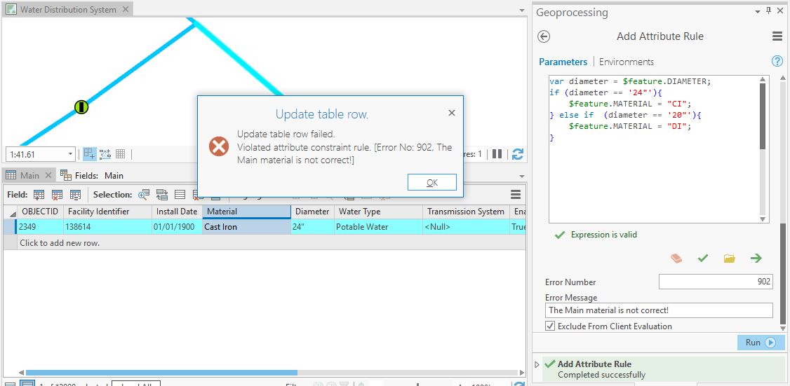

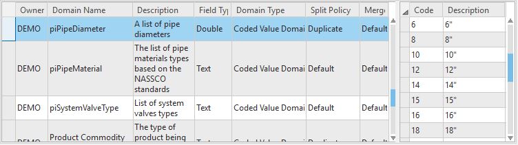

VyNguyen3
Hi Xander, my goal is trying to insert or update attribute data in 2 fields of a feature class which are Diameter (Double) and Material (Text), assigned respectively with 2 Domain Code descriptions as below.
Technically, I want to apply the value of Material corresponding to the value of Diameter that I put in the code. Besides, I test with your code and the problem remains unsolved.
I dont really know that it could return the list of values in Arcade or not but I read somewhere that we could identify var result () and then return result in the code. I try many expression with this idea but never succeed.
Lastly, I test with the simple expression as you could see in the pic below but I failed to edit as well.

If my eyes don't deceive me I notice the diameter value being 20" (including the quote indicating inches). In case the field is a text field you will have to use a string comparison.Try this simple expression to see if assigning a value works:
var diameter = $feature.DIAMETER;
if (diameter == '24"'){
    $feature.MATERIAL = "CI";
} else if  (diameter == '20"'){
    $feature.MATERIAL = "DI";
In case the field is a field with a domain, the value should be handled differently.

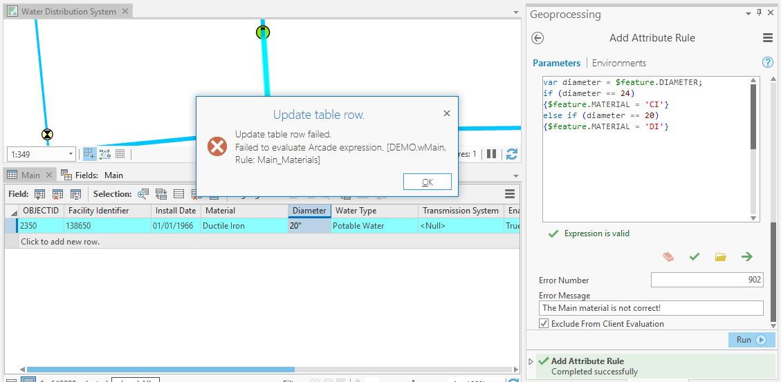

VyNguyen3
I try again and it still returns errors as below.
I dont know why the Constraint Rule is so complicated because I wrote a code for the Calculation Rule with the same context but for another layer (fields with domains) and had no problem. This just becomes extremely hard for a non-developer like me to define a rule.
XanderBakker
Esri Esteemed Contributor
OK, now it makes more sense. I thought you were trying to implement a calculation attribute rule that assigns a material based on the diameter. However, you are implementing a constraint attribute rule that checks if a valid material is specified for the given material. A constraint attribute rule must allows return a boolean (true of false). True the constraint is met and false when an error message should be provided. I will have another look at the first expressions you provided to see how these should be changed.
