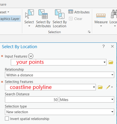

Here's a simple solution for you:
You need a dataset for the US coastline (see below). and then use the select by location tools

DanLee
by Esri Regular Contributor
You can run Near tool with the coastline as the Near Features and 50.0-mile as search radius.
You can also use Select Layer By Location using "Within a distance" option and the same search radius.

DanLee
