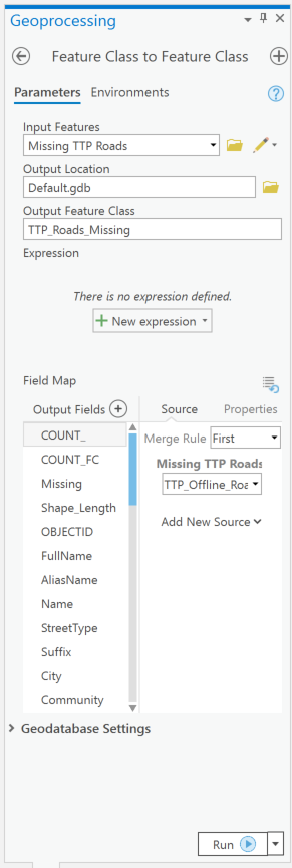

I am trying to use the feature class to feature class tool. It exports the polygons properly but none of the attribute table fields get populated.

I am trying to use the feature class to feature class tool. It exports the polygons properly but none of the attribute table fields get populated. I am trying to export a feature class that has a join.

Hi Luke,
When you are selecting the feature class, are you using the dropdown for the Input Features, or clicking the yellow folder to browse to the feature class.  You will want to do the former as this will honor the join within the Pro project.

Can you provide some screen shots of your workflow and the results?

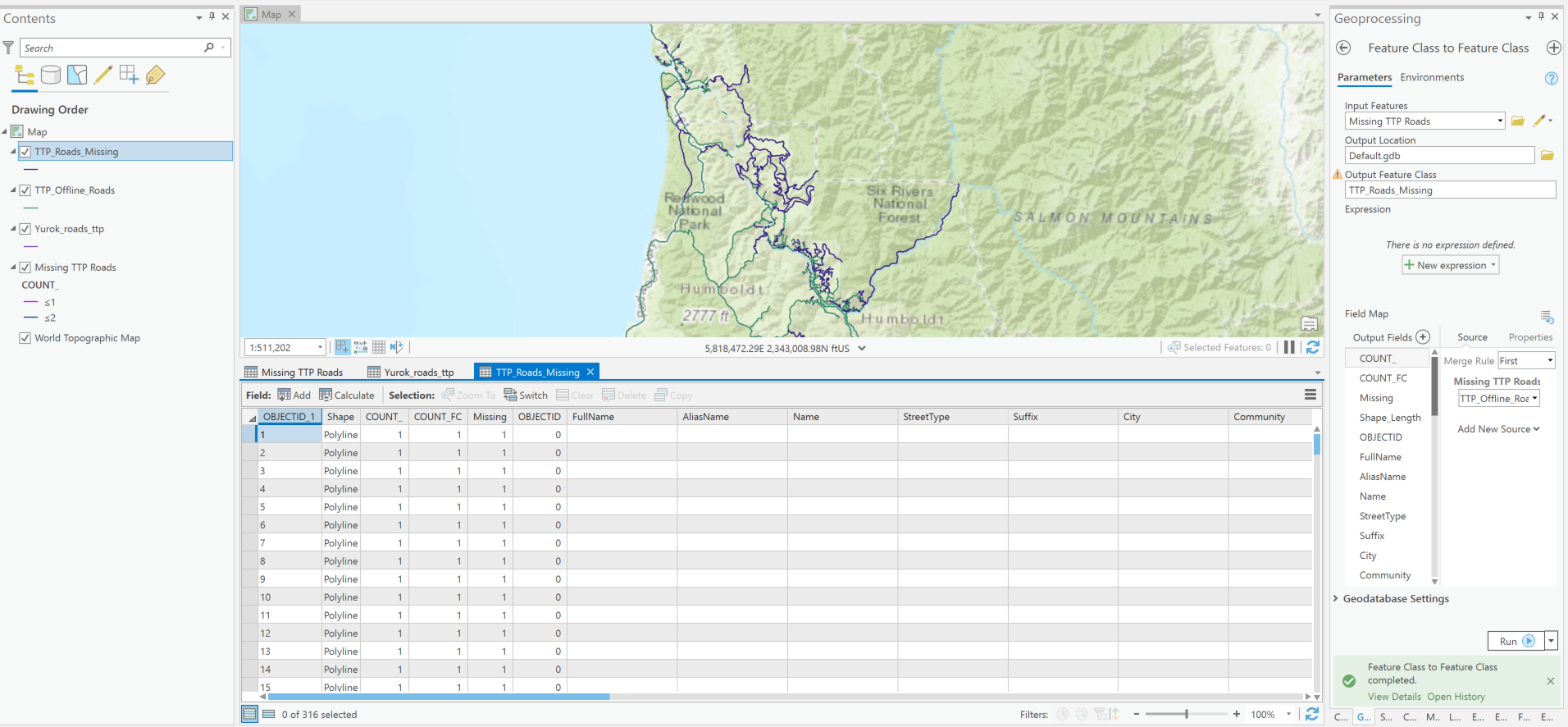

LukeSupahan
Yes I can. Before I do though I should add that one of the joins is a layer that came from the count overlapping points tool. Would that have any effect on things?

Okay, let's try this for testing purposes.  Create a copy of the feature class and non-spatial table in the new geodatabase.  Build the Join and export out to a new feature class in the new geodatabase.  Same result or does it work as expected?   Please advise.

I actually didn't make it to exporting out to a new feature class. When I joined this time almost none of the fields were populated.

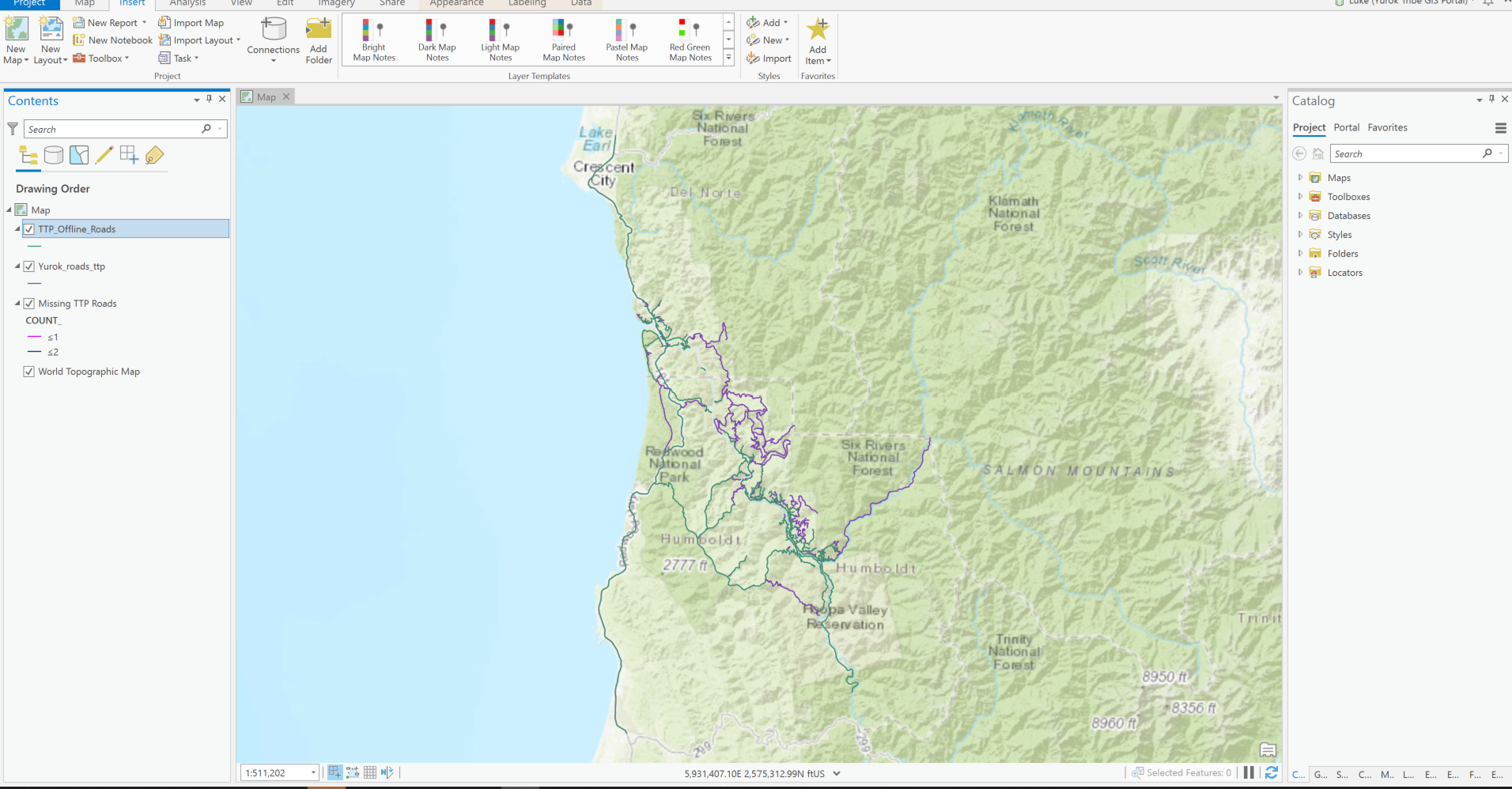

My project was to find roads missing from one layer that are on another. I ran the count overlapping tool, set the minimum to 0 so that roads with only 1 count would be the missing roads. The problem is that no information is in the count overlapping table so I need to join to get the road name/information.
