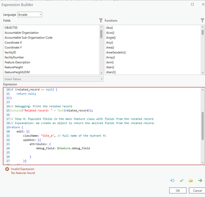

JeffTimm
yeah I updated my code but still get an error.
Invalid Expression
No features found

JeffTimm
it would be good news if I ran it and got that message but that is in the expression builder.  I can't even save it at this point.
ESRI makes it hard to debug in this interface.
