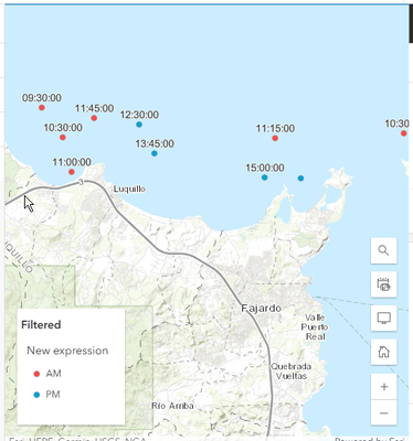

You can use the Text function's formatting parameter "A" to return "AM" or "PM" for symbolizing the points.
Here's an example. These points are labeled with the Collection time field (FishDate in my data) and I use this expression to symbolize them.
Text($feature.FishDate, 'A')
When you click Run in the Expression editor, it uses the first record in the dataset to evaluate the code. Clicking Done will run the code on the entire dataset (or at least the first thousand or so records) to build the symbology

you're amazing!! it worked, thank you so much.
