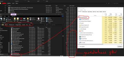

I've noticed a few things recently:
a process from the ArcGIS 'bin' folder called 'ExcelToSQLLite64.exe' is running in the background using 6% CPU and almost 500MB of RAM when I don't even have Pro open. I haven't opened it all day.
This screenshot is from today, where multiple .geodatabase files are still being created within seconds of each other (see red circle in middle of screen). Further clogging up my hard drive.
