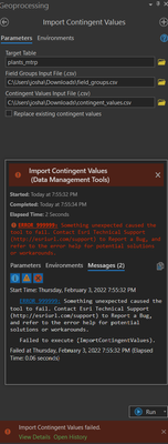

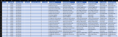

I keep getting errors and crashes when running the Import Contingent Values tool. If anyone can tell me what I'm doing wrong, I would appreciate it. I think it has something to do with my SUBTYPE and SUBTYPE_NAME values, but I'm not sure which values to use since I'm not using subtypes. Here's my errors, my FieldGroups.csv, and ContingentValues.csv:

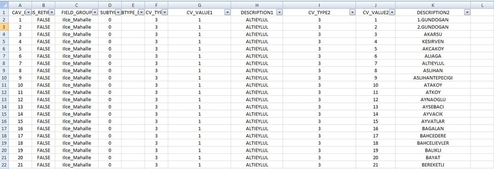

BalikesirBüyükşehirBelediye
have a nice day, I also dealt with this error for a long time, and finally I solved the problem with my own logic. The mistake we made here is that we enter a text value under the "CV_Value" column. What should be done is to give a single code to the repeating values, as we did when creating a domain. ıt will be better understood in the example image.
LayerItOn
Oh my goodness you have saved me!!!! Your comment matches the contingent csv form set up here: https://www.esri.com/arcgis-blog/products/arcgis-pro/data-management/how-to-import-contingent-values...
