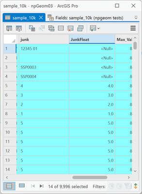

DanPatterson
MVP Esteemed Contributor
Or if you don't want to use a code block... (substitute !junk! for your field name of course)
float(!junk!) if !junk!.isnumeric() else None
... sort of retired...

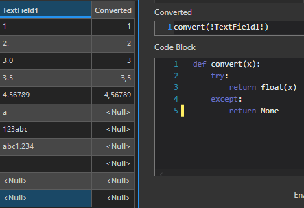

JohannesLindner
MVP Alum
Create a new Double field, then run Calculate Field with this Python expression (note the exclamation marks in line 2):
# NewField =
convert(!OldField!)
# Code Block
def convert(x):
    try:
        return float(x)
    except:
        return None
Have a great day!
Johannes
