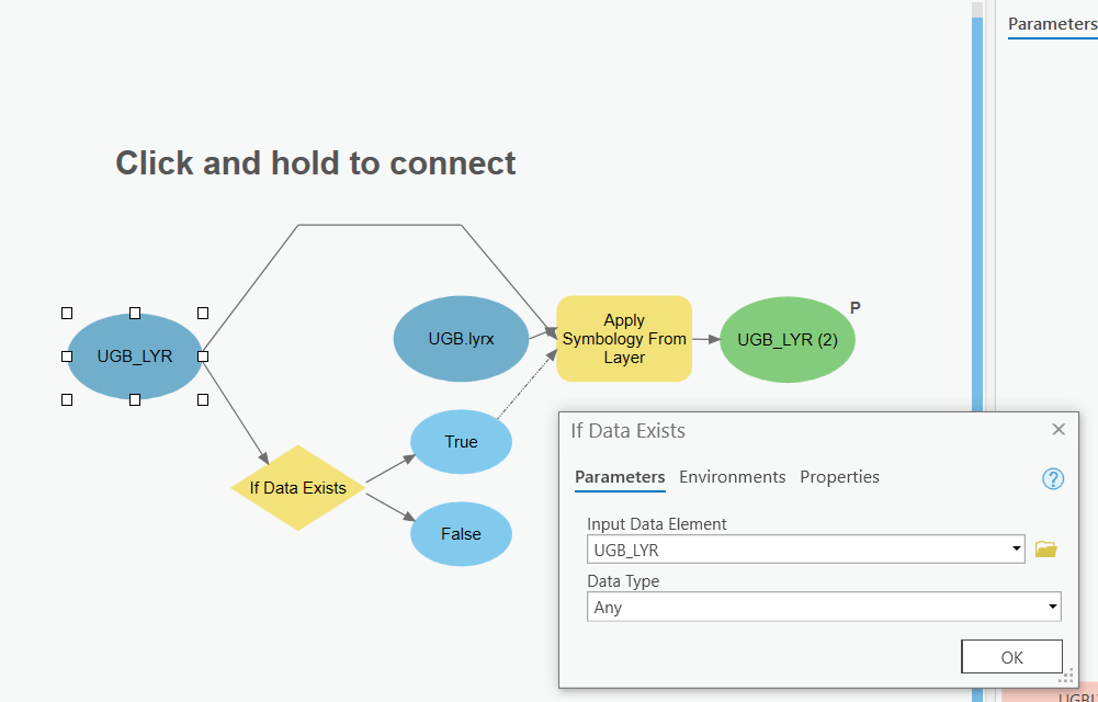

I am attempting to build a model to test whether a layer exists in the current map, and if true, run the command ApplySymbologyFromLayer on that particular layer as follows:
The 'If Data Exists' doesn't seem to be the right tool to test whether a layer exists and the tool runs with an error:
Failed to execute. Parameters are not valid.
ERROR 000735: Input Values: Value is required
Failed to execute (13UGBLYR).
What would be the correct tool to use to check whether a layer exists in the current map?

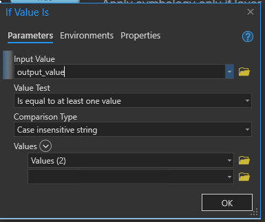

Configuring the If Value Is tool
Set the output of the Calculate Value to be the input Value to check.
Keep the default value for the Value Test "Is equal to at least one value"
Set the Comparison Type to "Case Insensitive string"
Values - you only need to type in PRESENT. This is important because you only want to test for the "True" branch condition. Any other value (i.e. NOTPRESENT) would trigger the false branch.
This should do what you need.

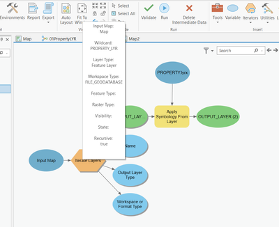

LeandraGordon
Thanks Andrew, I'll give that a go. I'm trying to get around a Python bug with Apply Symbology so it would either be run the model in the Python Script or run some Python in the Model 😄
LeandraGordon
In the end I used the iterate Layers and set the wildcard to the layer name itself.
Slightly clumsy but it will suffice until the Apply Symbology from Layer bug is fixed in Python Toolboxes (and Jupyter Python as well!)
