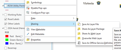

From the table of contents, you can right click on a layer and go to the Sharing menu, then export as a .lyrx file.

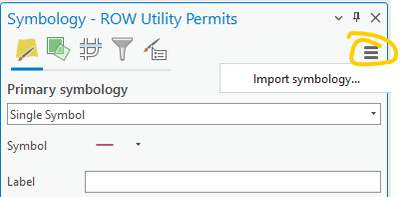

Store those all in the same place. Then when you add layers to a map from a database or folder, you can use the Import Symbology geoprocessing tool (or click on it from the symbology menu) and target the .lyrx files you created.
You can also just add the .lyrx files to the map as well, though there are more limited capabilities on what you can do to the layer that way.
