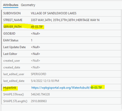

Hello!!
The layer I'm working with has a SERVER_PATH and Hyperlink  attributes. I want the values  of the SERVER_PATH (which are different for each asset)  to automatically  go to the end of the hyperlink.  I have all the values for the SERVER_PATH field and have been populating each hyperlink individually. Any ideas on how to do automate this process?
See below picture
Thanks!!

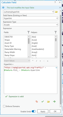

dalvarez
Thanks!
this expression worked for me:  "https://wpbgisportal.wpb.org/Traffic/" + $feature.FILE_ + $feature.Hyperlink

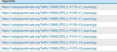

A hyperlink was created for every asset
