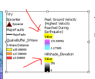

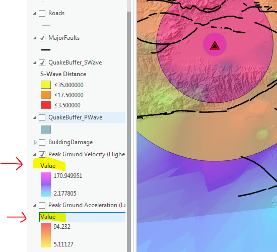

I was just wondering whether there was a way/the best possible solution to removing the sub-heading 'Value' from the table of contents. Reason being that when I try and create a legend on layout view, there does not appear to be a way to delete this sub-heading (see images for reference). Thanks.

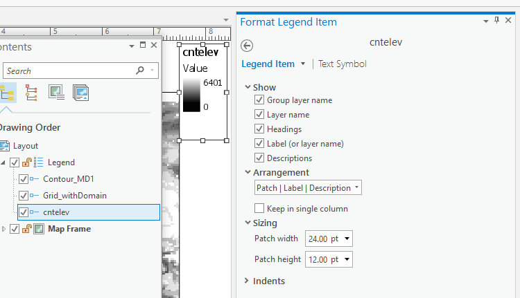

With the Layout in focus, select both of those raster layers (Peak Ground Velocity and Peak Ground Acceleration). Right-click one of them > Properties. This should open the Format Legend Item pane. Mine is on one layer, yours should say [multiple items].
At this point, we see Value in the legend.

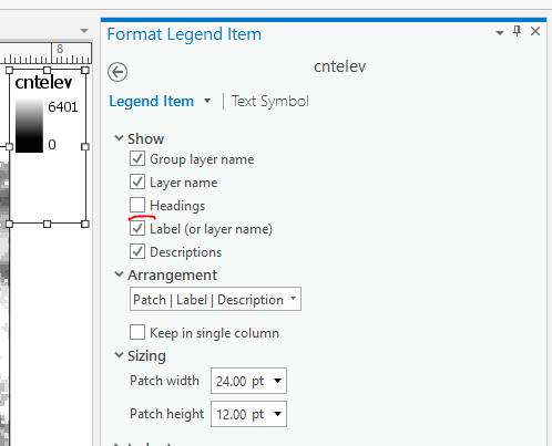

Uncheck Headings in the Format Legend Item pane.
Voila!
