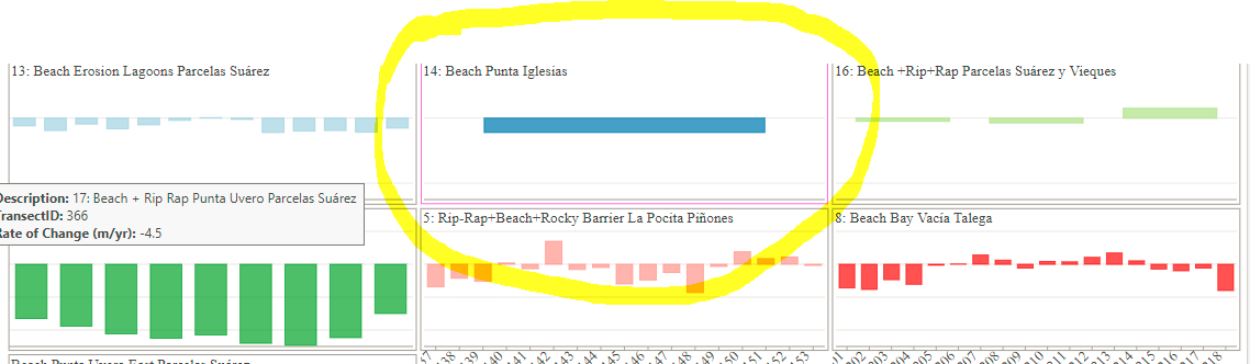

Hi:
On the Chart Properties>Series>GRID I can divide the results by groups (which is awesome!).  There is an automatic pink line around the one the GRID, I am able to select others with the Pink Link.
But, how I can unselect one grid in order to have the same border color for all Grids?

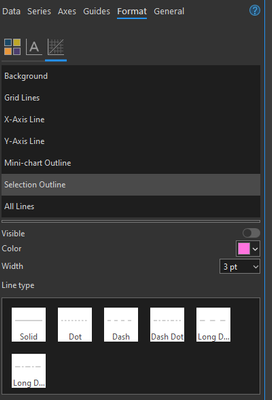

MadisonLambert
Just kidding I found it! Just had to turn off the Selection Outline in the Format tab!

ChristopherAllen
Hi @lbraceromarre ,
Thanks for the question! The selection outline is primarily used to select a mini-chart to be viewed in the preview chart. We understand that when the preview chart is not displayed, it might not be desirable to show the selection outline. There is currently no way to turn off or change the formatting for the selection outline, but we plan to address this scenario in a future release.

MadisonLambert
Hello,
Any chance this issue has been resolved? I am trying to export a map with a series of line graphs from one data source using the grid series, the pink still shows up.... Any chance you have alternative options for grid series without the interactive selection?
MadisonLambert
ChristopherAllen
@MadisonLambert Awesome, thanks for posting the follow-up! Yes, in Pro 3.0 we added a "Selection Outline" option in the Format tab that allows you to format the mini chart selection outline (including turning off visibility).
