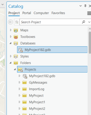

How can I remove or delete the MyProject folders and geodatabase from Catalog? (see below)
Or, better yet, is there a good way to avoid this in the first place?

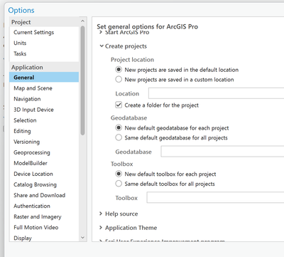

Yup. Go to the settings where Dan posted a screenshot and you can modify your Pro projects to do what you need. This will only work for newly created projects, going forward. For existing projects, to delete the default gdb, you first have to make another gdb the 'default' (right click on it from the Catalog and make it the default). Then you can delete the not-used gdb.

The My Project geodatabase is created with your project and is the default geodatabase. It has to remain in the project folder. If you don't want it, you need to assign another geodatabase as the default geodatabase, and then you can remove it. If you truly wanted to delete it, just go to the folder in which your project was created and delete it there. This will cause your project to not work properly as it will be looking for the geodatabase. Why do you want to delete your default geodatabase?

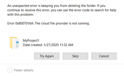

As it stands now, I have over 200 MyProject folders/geodatbases that are just wasting space. I get an Error  when I attempt to delete them -- see screenshot. Is this perhaps a problem with my OneDrive where they're stored?

What Adrian is referring to is in the Project backstage
Craig_Eissler_Iceman
Unfortunately, the 'General Options' don't really solve my problem because there is NO option for NOT creating a default Geodatabase. Personally, I think I'd just rather have a default 'Folder' that stores everything for my Project, and then "Browse" from there where I want to save my outputs.

So, I'm just down to how to Delete my default MyProject projects (.aprx's)..? And, I get an Error when I attempt to.

As for being able to "delete" old 'MyProjects': It was a OneDrive issue that was not syncing. But, now that it is, I'm able to delete those old folders and files.
