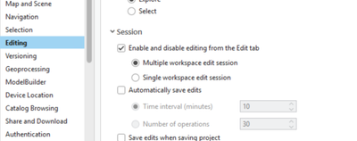

I know that an edit session isn't the same / not required in Pro. But many of my users are still new to Pro, so I suggest they follow the instructions in this link, to enable editing from the edit tab.

I have a c# Add-In for ArcGIS pro. I would like my program to be able to determine if my user is in an edit session, or no.
