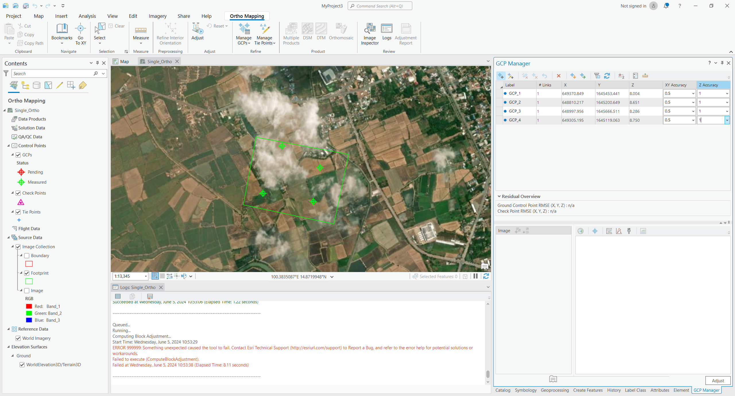

Hi everyone,
I have some questions about ortho mapping. Is it possible to perform adjustments using a single image? I tried processing an image for ortho mapping, but I encountered an error. Does anyone have suggestions, or has anyone successfully created an ortho mapping from a single image?
Thank you
Jake
johnpol
I think that you cannot, you need to create tie point and do the aerial triangulation, with one image that is not posible, if you want to georeference with control points that single image you can go to Imagery and Georeference. To understand better the process of orthomapping I suggest to search about photogrammetry and
