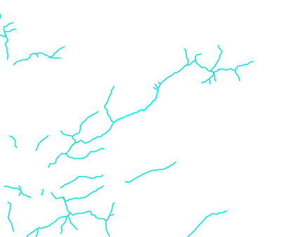

I am looking for a method to merge intersecting line segments over a large dataset. In figure 1, I used the method by first selecting individual line segments, followed by the tool merge (in the edit toolbar). This 'manual' approach is very time consuming and I guess a more automated approach would speed things up.
The first approach I was thinking about was using the dissolve tool. However, if I check 'Create multipart feature', all my segments are dissolved into one feature, see fig 2. And if I leave the 'Create multipart feature' unchecked, only the overlapping features are merged, but not the intersecting (tributary) lines. I also tried checking the 'Unsplit lines' box without success. Does anyone here have a recommendation?
fig 1, manual approach by selecting the polygons, then use merge in the editor toolbar.

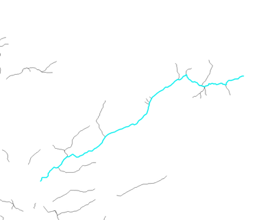

fig 2 dissolve with 'Create multipart feature' checked

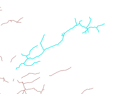

Here is a workaround that has worked for me.
1. Using the polyline layer, create a buffer (I created a 2 meter buffer with other parameters as default).
2. Dissolve the Buffer layer (Keep both "Create Multipart Features" and "Unsplit lines" unchecked).
3. Add a new field "ID" (Datetype:LONG) to the dissolved buffer layer, and transfer the "ObjectID" values to it.

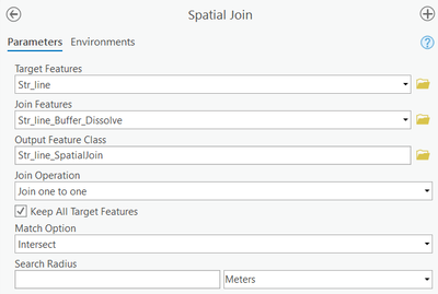

4. Using Spatial Join, transfer the attributes of Dissolved Buffer polygons to the original Polyline Features.
5. Now, Dissolve the Polyline Feature (Joined) based on the "ID" field (Check "Create Multipart Features").

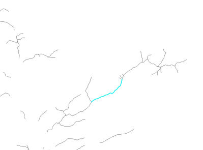

Anyways, here is the 'seed' line which I want to merge to the intersecting lines (but then of course for all clusters eventually) :

Thank you for your reply. I did try that. The problem is it disintegrates the multipart feature (covering all the line segments) into single part features (splitting the line segments along the intersection points). This is not the result I was looking for as I am trying to merge the intersecting lines. This is what I get when I select one segment after 1. Dissolve and 2.  Multipart to singlepart:

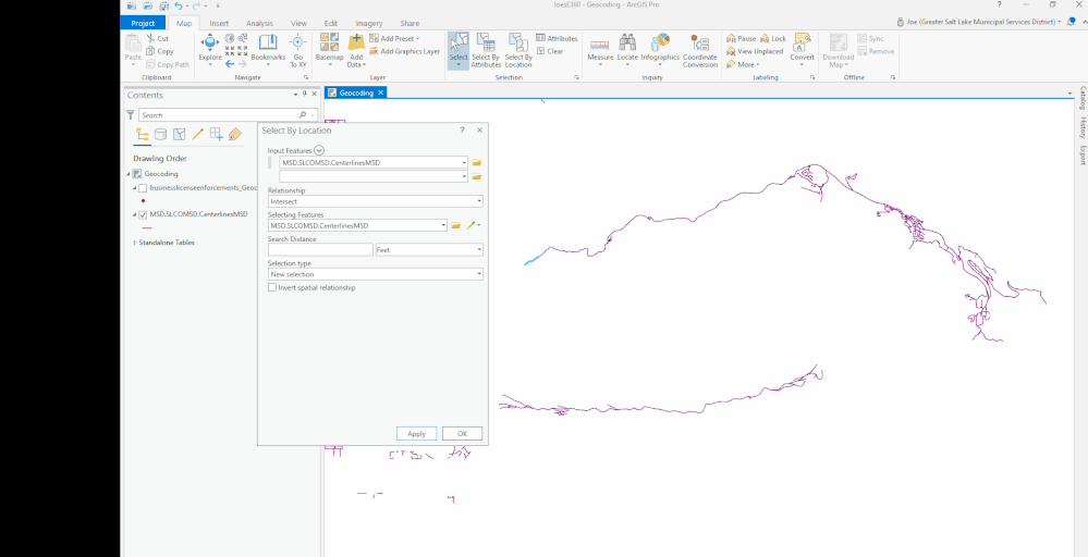

I think this gif shows what you want to do, right?  It starts with a single selected segment and recursively spatially selects intersecting segments.  The recursive part can be automated; you'd need to add some sort of counter to tell you when you've selected all the intersecting segments.  To me, planting the 'seed' is the tough part.
Think Location
Mikis
Thank you Jayanta, this was indeed what I was looking for.
