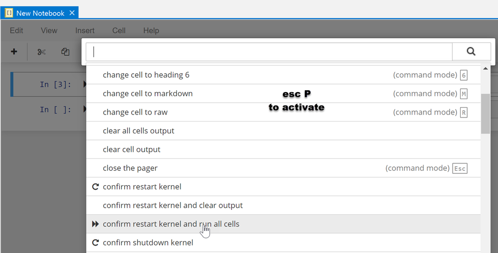

DanPatterson
MVP Esteemed Contributor
esc P
does it look like this?
... sort of retired...
ChrisCowin
@DanPatterson, Yeah I tried the "confirm restart kernel" and on the notebook it seemed like it stopped but the code was still selecting features after it was restarted.
