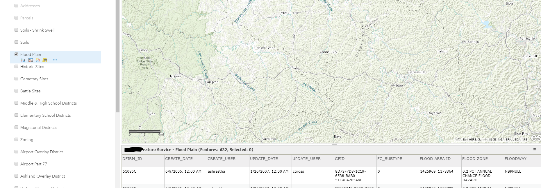

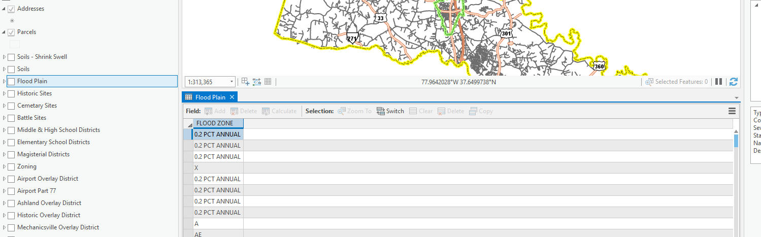

I have published a map service from an ArcGIS Pro project where I have turned off most of the fields in most of the layers.
I expected only the visible fields to be available in the feature service, but when I pull the service into a map and open the attribute table, all the fields are visible.
Is there a way to hide the fields before publishing?
I am giving the rest endpoint to a third party for use in a map, so I can't hide the fields myself in the map.
