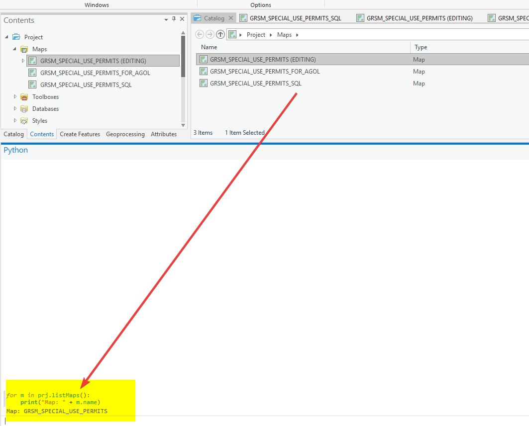

ThomasColson
MVP Alum
I spoke too soon....
ThomasColson
MVP Alum
So here's what's going on. Despite the clear existence of the 3 maps...
MatthewDriscoll
MVP Alum
Interesting that the print leaves out anything after "PERMITS".  Perhaps a Map cannot be named so many characters long or something?
MatthewDriscoll
MVP Alum
You might want to call technical support.  I just tried this about 20 times using your naming and some others and I was able to replicate it the same problem.  However it only happened a few of the times, which was strange.  I did nothing different when those few failed.  Maybe a bug.  Sorry I don't have more for you.
