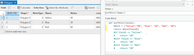

UPDATE: It seems like it was working, but for whatever reason ArcGIS Pro was not updating the rows visible without scrolling, so it looked nothing was happening. Why it would torture me like this, I have no idea.
I've uploaded a screenshot just in case this happens to anyone else and they think they're going crazy.

Simple way: Select by Attribute, then field calculate for each attribute like you were doing before. First the Yellows, then the Blues, etc.
Less Simple but 1 step: Field Calculator (Python)
def buffDist(field1):
    ''' Create Dictionary and pass the values through it'''
    bDist = {"Yellow":"40", "Blue": "50", "Red": "60"}
    return bDist[field1]
    '''Alternatively, you can spell it out like this, but that's more
        more work for you.
    #if field1 == "Yellow":
    #    return "10"
    #elif field1 == "Blue":
    #    return "20"
    #elif field1 == "Red":
    #    return "30"
  1. Paste the expression into the codeblock
  2.  Then call it in calculation field with buffDist(whateveryourfieldis)
