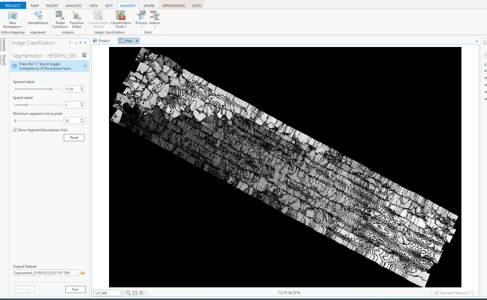

I would like to extract the segment boundaries that are generated by the Segmentation tool in ArcGIS Pro, because I am interested in delineating the boundary of the features. When I ran the segmentation tool, I only get a raster file of the segmented image but without the segment boundaries.
Is there a way that I can extract the polygons in the image below into a shp file?
Thank you.

Have you tried Raster to Polygon?
DaphnieGalvez
Yes, I did but the segmented raster image didn't look the same as in the preview.
It looked like this, so there polygons are different when I converted the raster image to poly.

Did you specify No Simplify in the tool?
NO_SIMPLIFY The edge of the polygons will conform exactly to the input raster's cell edges. With this option, converting the resulting polygon feature class back to a raster would produce a raster the same as the original.
DaphnieGalvez
Yes, I also tried that but this is what I got. Just the same features of the raster image.
Thank you for your answers.
