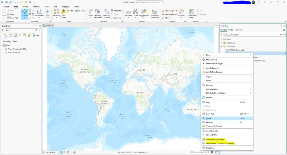

Janis - so when you refer to edit an *.sde connection, are you referring to this or something else?  Please advise.

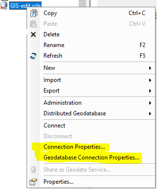

JanisT
Need this from ArcCatalog
Robert_LeClair
Esri Esteemed Contributor
It's there.  See my graphic below.
