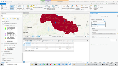

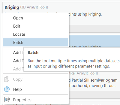

You could run the desired Interpolation tool in batch.
e.g. Run Kriging as a batch tool.
Choose "Z value Field" as your batch parameter. You could save the batch tool as well.
After choosing the input point feature, you can select multiple fields from the drop-down of "Batch Z value fields".
You may note that the output comes with an inline variable substitution, "%Name%", which helps in creating multiple output raster files in a given workspace.

Thanks  Jayanta. I also found another solution in Pro by using the batch option in the feature to raster conversion tool.
