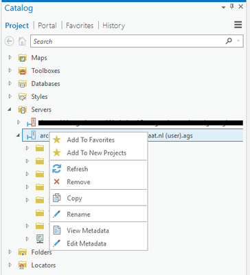

Hello @JakeSkinner
Thank you for the response. I did check this link out before posting the question however, I am unable to find the server properties. I only have publisher rights. Do I need to have more rights?
JakeSkinner
Esri Esteemed Contributor
It looks like you only have user privileges from the screen shot.  I see (user) in the AGS connection name.  Can you verify you have publisher privileges?
