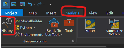

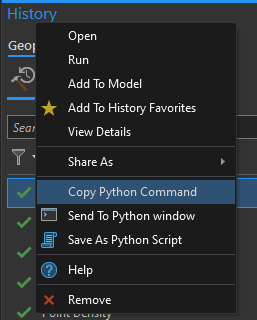

The most effortless way is running the tools manually, then going to the Geoprocessing history and copying the commands into a Python script:

Just to show how you could create your own script, I'll run the tools manually and then copy/paste the Python commands from the history here. Note that I'm using memory paths for intermediate results. This means they are only stored in RAM and thus will be gone when I close ArcGIS. The advantage is that this way is much faster than saving on disk.

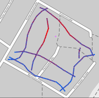

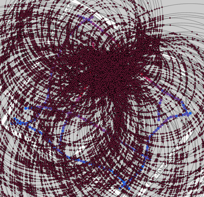

My input data, area is ~ 250m x 250m, signal strength is calculated using the formulas from the links below plus a little noise.
Calculate the distance of your measured points to the transmitter. In this thread and this wiki page, you can find formulas to convert signal strength to distance to the transmitter.
arcpy.management.CalculateField("points", "Distance", "dist(!DoubleField!)", "PYTHON3", """def dist(fspl):
    k = -27.55
    f = 2413
    pot = (fspl - k - 20 * math.log10(f)) / 20
    return math.pow(10, pot)""", "TEXT", "NO_ENFORCE_DOMAINS")

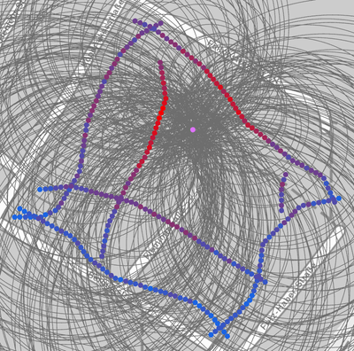

Create buffers around the points based on the calculated distance.
arcpy.analysis.Buffer(r"memory\points", r"memory\circles", "Distance", "FULL", "ROUND", "NONE", None, "PLANAR")
Intersect the buffers with themselves, specify point output.
arcpy.analysis.Intersect(r"memory\circles #", r"memory\circle_intersections", "ALL", None, "POINT")

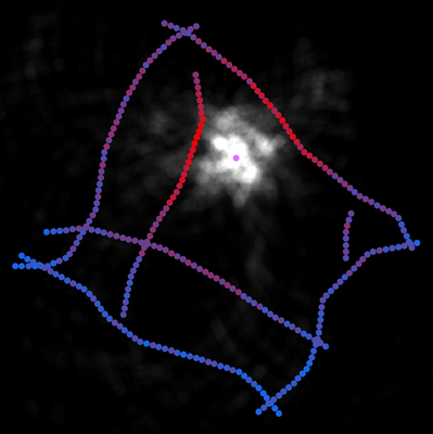

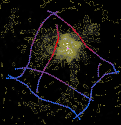

Create a heat map of these intersections (Point Density). Play with the Output cell size and Neighbourhood parameters, they massively influence the result.
out_raster = arcpy.sa.PointDensity("circle_intersections", "NONE", 1, "Circle 5 CELL", "SQUARE_METERS"); out_raster.save(r"memory\heatmap")

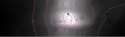

The area with the most intersections of the buffers should be near the transmitter. Create Contour lines to find this area.
arcpy.ddd.Contour("heatmap", r"memory\contours", 1, 0, 1, "CONTOUR", None)

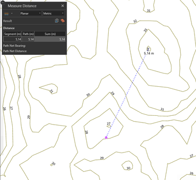

That's pretty busy. Let's zoom in.
Slightly over 5m off, not too shabby!

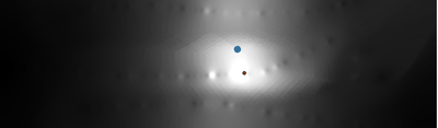

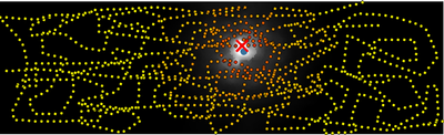

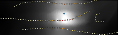

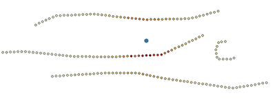

One possible way: Interpolate a raster of signal strength. Your elongated point distribution might make this not really exact, it would be better if you had some points in between.
My input (signal strength as inverse distance to the source plus some random noise)
Interpolate a raster, eg using IDW (Spatial Analyst)—ArcGIS Pro | Documentation
(you can already see that this might not show the actual source, due to the point distribution)
You can use this raster to guess the source spot. You can also analyse it further:
Contour (Spatial Analyst)—ArcGIS Pro | Documentation
Raster to Point (Conversion)—ArcGIS Pro | Documentation, sort by value field, delete all but highest

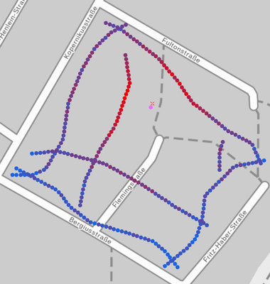

Here's the same process with a more random point distribution. The calculated source point (red x) is much closer to the actual source:
