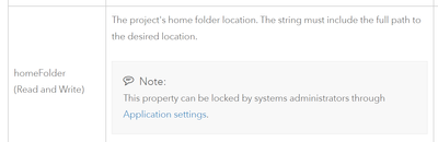

Dale_Honeycutt
In scanning the doc, I found there are some caveats to the project directory
  • The user needs to save the project first, otherwise it goes to some default home location that'll be lost when they save for the first time
  • Then there's this:
Seems like filePath is a better option than homeFolder
https://pro.arcgis.com/en/pro-app/latest/arcpy/mapping/arcgisproject-class.htm
