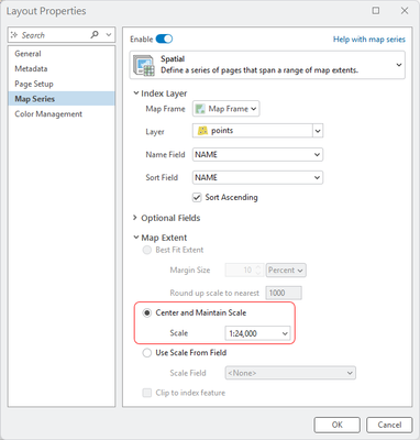

JesseWickizer
Unless you need the polygons for some other analysis, you don't need extent rectangle polygons to create a spatial map series for all of the features. Create the Spatial Map Series and then set the Map Extent to Center and maintain scale.
