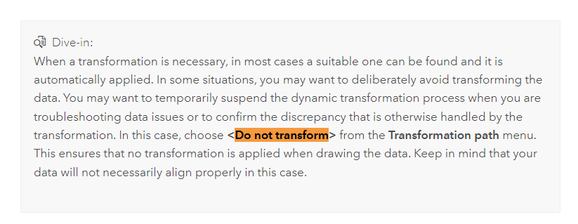

https://pro.arcgis.com/en/pro-app/latest/help/mapping/properties/specify-a-transformation.htm

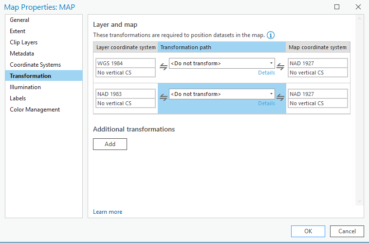

According to this documentation you can select "Do not transform" for each layer in the map.
In TOC right click on the map name and select Properties.
In the Transformations pane select "Do not transform" from the drop down menu for each layer.do not transform2.png
I know this doesn't do what the original post was asking but it might help for those who use the clear coordinate system feature to stop the on the fly transformations for QC or other purposes.
