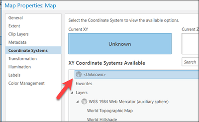

ArcGIS Pro introduces Unknown coordinate system in 3.2. Is that not working for you?
https://pro.arcgis.com/en/pro-app/latest/help/mapping/properties/use-an-unknown-coordinate-system.ht...

 I saw it but to me, Unknown did not have the same meaning as "Clear" coordinate system.
Please close.
