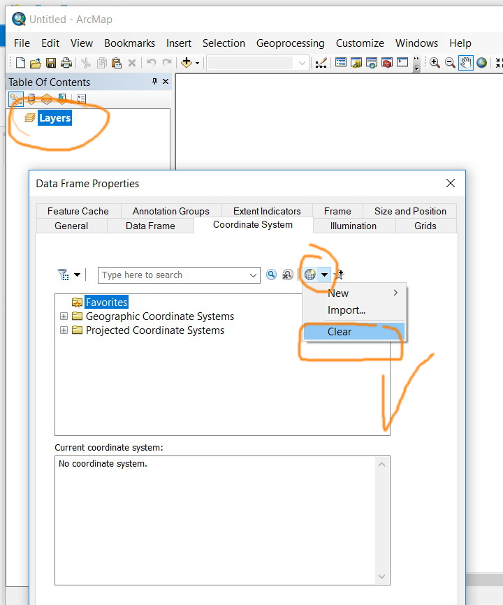

For example, in ArcMap, the clear option is available and one can set the “data frame” to unknown. I couldn’t figure out how to “clear” the coordinate system of the “Map” to get it to “unknown” in ArcGIS Pro as this option is not there

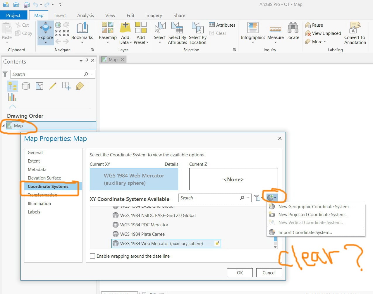

It appears that Pro fails to take the “unknown” coordinate system. As it is selected, it gets back to the previous coordinate system (as shown in the screenshots below).
What could be the issue here?

It appears that our life gets hard without “clear” option. Clearing the coordinate system of data frame or layers helps us understand the data we receive. It is very common in our environment to receive data with unknown coordinate system, then the fist step is to investigate the data and then to assign the proper coordinate system.
For example, clearing the coordinate system of the data frame brings the layer to their absolute location and thus we understand how they are different from one another.

This appears not to be fixed even in 2.3. “clear” tool is not there!
Why do I need it?
In the screenshot below, I have two layers, on in ITM coordinates and the second is in Palestine 1923 Grid. Now, how can I clear the coordinate of the map (data frame), so that I can see these two layers in their absolute values (as it is used to be performed in ArcMap since ages!)
I would love if this tool gets back!
