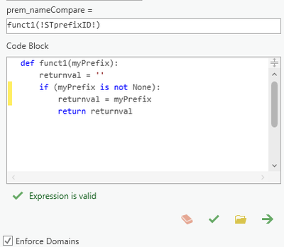

I'm calculating field1 using code block and python.  The script checks if field2 value is not None.  If true, I need it to calculate field1 to be the domain value not the domain code of field2.  I'll provide the script below.  Checking "Enforce Domains" does not help.  Result is always the domain code not the domain value.  Result should be 'N' (domain value) and not 3 (domain code).
Thanks for any guidance.

The value will always be the code from the domain in your script not the description. Unless you're only wanting to display the descriptions in the table.
Otherwise, if you want N to be there you would have to add N as a code to the domain for this value to be acceptable.
Currently N is the description of the code 3 within your domain.

PLadd
Thanks @CarsonG .  You saved me a little time and diverted my attention to figuring if this will work in Arcade, which I'm happy to report, does allow you to capture domain values.  For anyone trying to figure this out with Python (or stuck figuring it out with Arcade), below is my Calculate Field code that will test if certain values are null or not and calculate the domain values into another field accordingly.
