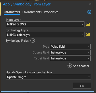

I use a model to clip four different areas to features and apply symbology to them from a lyrx file. The lyrx file has all possible symbology items which may or may not be present in the four clips.
In the result each clip has all symbology items and I have to use 'count' and manually remove the non-existent items.
I would like to see only the existent symbology items after my model, what can I do? I'm sure I have seen this before but I can't find the setting
Thanks for your time,
Bert

Apply Symbology From Layer (Data Management)—ArcGIS Pro | Documentation
maintain ranges setting? Not sure for modelbuilder if it is an environment setting or not

Gisbert61
Brilliant Dan!
Changing 'default' to 'update ranges' which is a setting solved it, Thanks!
