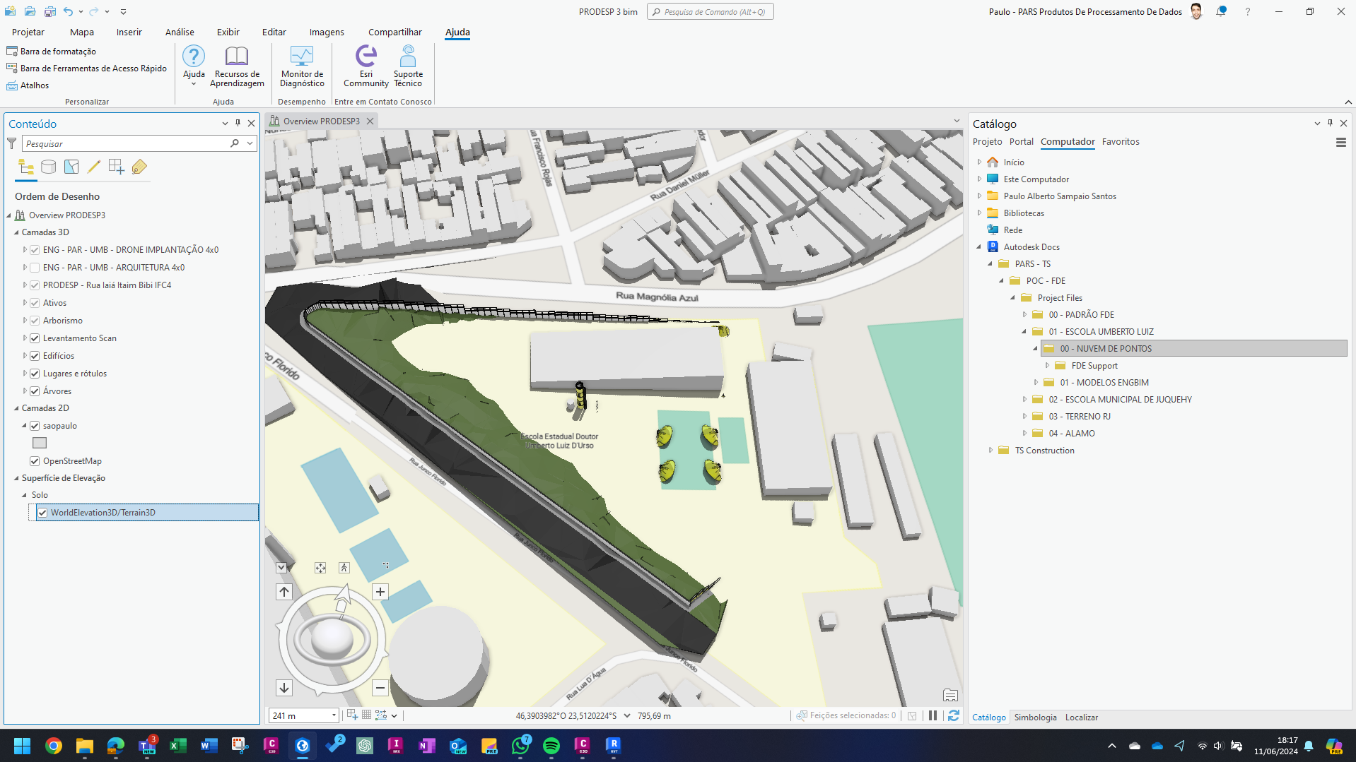

I added a 3D model to a map that uses the 3D basemap from OpenStreetMap. However, there is an excavation at the location, and I would like to represent this using the 3D model, but I'm having trouble with this basemap. How can I adjust the elevation in this area of the basemap so that it cuts out the 3D model and uses the elevation from the model in this spot?

Hi Taren, I've tryed this way and I think this might be the only possible way.
It works. Thank you for your feedback
