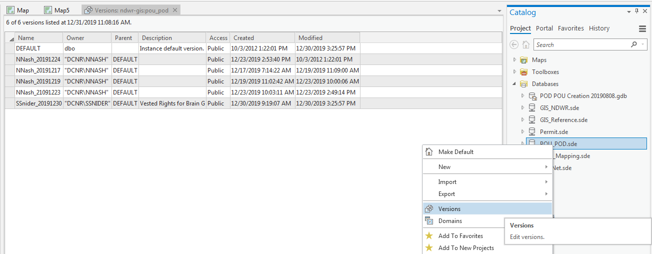

StephanieSnider
Just to follow up.....to see the version manager without editing, right click on the SDE connection (with data owner or admin rights) and select Versions. That's it.
