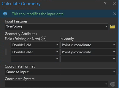

Caclulate x and y coordinates in the point fc

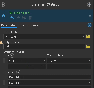

Run the Summary Statistics tool with statistic type Count and the coordinate fields as Case fields.

Modifing the original data seems a tad clumsy and suggests the need for a back up copy of the original.
The output is a table and not a shape file, hardly a major problems but inelegent.
The sum of ObjectID is also inelegent, but again not a problem.
