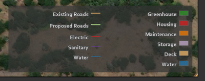

Any updates on this, @KoryKramer ? I just spent half an hour troubleshooting this in 2.8.2 (am stuck in a long project before my next update, but this sounds like an old bug).
There's absolutely nothing logical about turning on word wrapping to solve a right-aligned patch failure, and I only found this solution by way of a person having difficulties with right-to-left text.
BrennaHughes
In 3.0.0 I can get it to right-align with word-wrapping, but I can't get rid of the huge useless space when it's right-aligned:
I've checked all of the spacing & indent settings. If I try to control the width manually, I get the dreaded red dots.
I tried the same with a single column & have the same issue.
However, If I break it into two legends and turn off half of my items in each, remove the background, and then draw a fake background behind it, I can get the effect I'm looking for.
I hope I never have to edit any of it...
