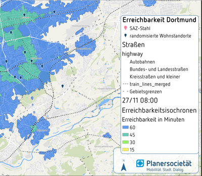

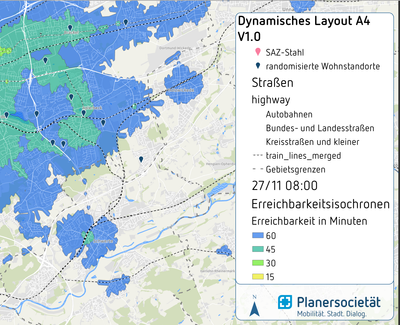

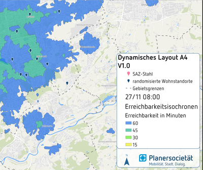

Hi. I have a similar Problem that I am unable so solve for about forever.
I want to create a dynamic Layout, that I can juse for most maps and do not have to adjust every time. Since ArcGIS does not offer the possibility to add a text field with a decent looking background that adjusts to the title of the Layout I integrated the title into the legend.
The idea is, that the legend grows upwards when stuff is added...
Buuuuuuuut, if it turns out that if the title gets to short... the legend shrinks in width.
This was probably my 100th attempt to solve this problem. None of the different fitting strategies have any (good) effect on this. Is there some workaround that I am missing? I cannot believe there is no solution to make automated map produktion not look like they are from 1950 or having to dial in everything by hand...
I would really appreciate some help with this.
