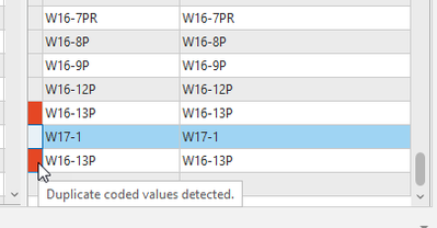

How are you trying to 'add' it?  Pro warns me and greys out the save button if I have duplicates.
R_

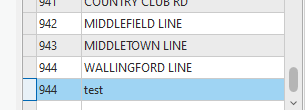

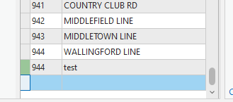

I go to the bottom of the list of domains, add a new record
and click the Save button.  The save takes.
Then when I query the coded value in a feature class and the new domain value shows.
Then I close/open the domain table and "WALLINGFORD LINE" is gone and only "test" remains:

OIC, I learned decades ago to not use numeric Domains for text fields in ESRI (mainly for lookup issues across software/platforms, but now yet another reason), so when I saw street names (though you clearly mentioned the number), didn't think to test that.
However, using numeric fields I can reproduce your issue in both 2.9.3 and 3.1.1.....
If I set up a domain with Long/Short, add an existing domain to it and save, it WILL overwrite the current value with no error/warning at all.

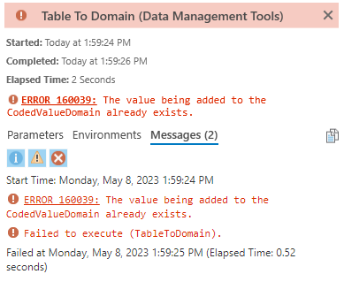

Upon furthur testing, I see both the GP tool (Table to Domain) and arcpy.management.TableToDomain both work as expected, and will give an error if you try to append a duplicate domain value.
Might be a workaround in the meantime.
R_
PLadd
Yes, this is a good workaround.  I can setup a temp table to be used with Table to Domain and append it to the appropriate domain as needed.
Here's the error I got doing Table to Domain (append) that I would expect if I were simply editing an existing domain value.  Thanks again @RhettZufelt.
