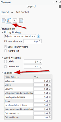

As in the below, I want to increase the spacing between the rows, which sub-sub menu is it under?

I believe if you right click the legend, and go to properties, you'll be able to adjust the spacing here:
It may also be the size of your legend or size of the font.
