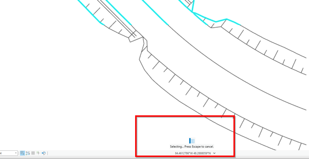

Hi all,
I am trying to delete unnecessary annotated road labels using the Selection tool under the Edit tab. It was working just fine until recently; Arc Pro highlights the label when I click on it but does not fully select it, and I cannot delete the label or press ESC to cancel the selection attempt. This freezes all other functions besides allowing me to swap between layouts or maps. See the image below:
My usual fix for this has been to delete the annotated feature class and remake it (after closing the program with Task Manager). Unfortunately, this no longer works.
I have tried deleting the labels from both activated layouts and the source maps but it makes no difference. Restarting the computer does not fix the issue either.
Does anyone know how I can get back to deleting labels normally?
Much thanks for any help!
--Spencer

Calling this a solution is incorrect. It is well know that there are rendering issues in Pro that have not yet been solved and this is one of them. This problem is not specific to annotations but all selections; anyone working in actual production editing environment experiences this all the time as the map rendering hangs all the time, specifically when making frequent selections with the  "Selecting... Press Escape to cancel." message. This is one of the reasons why myself and others when needing to perform many edits and selections still prefer to do these tasks in ArcMap which is lighting fast in comparison.
I would like to urge the OP to uncheck this as "Solved" as it has not been solved. OPs solution of copying data to a new map and working in that map until it starts causing issues is the only workaround for this. Clearly there is a rendering or caching problem somewhere. Not even mentioning I need to re-open map all the time sometimes restart the entire project to make Pro render things on the map and none of the workarounds, solutions, suggestions, etc. provided to date in numerous forums work. 2021-10-23 10_20_50-Window.png
