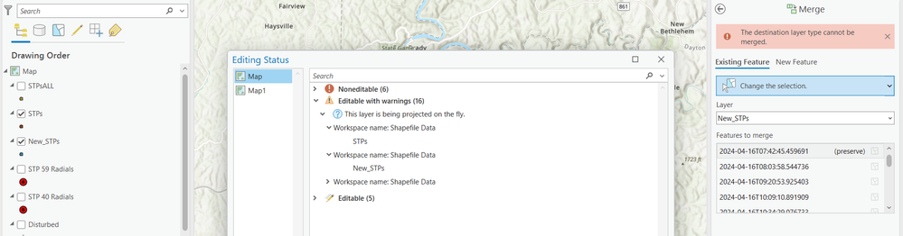

Screenshot 2024-05-14 213608.pngThis is the issue I'm having with the Merge tool. The two layers i'm trying to merge are both "point" types: "STPs" and "New_STPs", these are the errors I get.
DanHardwick
Hi. Can you not just use the geoprocessing tool 'Merge'? That allows you to combine the two point datasets into a single output, and also keep all fields... might do the trick?
jwrrenv
No, it says "The destination layer type cannot be merged."

jwrrenv
ok i got it to do what I needed by creating a new feature and importing fields from one of the features i'm trying to merge, then append worked by selecting Use the field map to reconcile field differences, it still warned about something. This makes my life a bit easier, thanks. I swear this software actively wants me to feel psychological torment.
